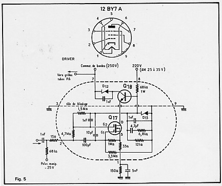

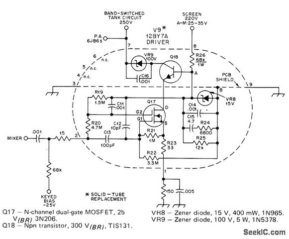

Per chi volesse ulteriormente mischiare le carte in tavola e complicare le idee a qualcuno :mrgreen: ;-)
https://www.chipsetc.com/the-fetron.html
http://www.philbrickarchive.org/fetron,%20solid%20state%20vacuum%20tube%20replacement%20teledyne.pdf
https://www.worldphaco.com/uploads/WORLDFETRON.pdf
https://www.qsl.net/kh6grt/page4/tubesters/Fsht7.pdf
12 BY7 A.jpg (40.07 KiB) Osservato 2077 volte
