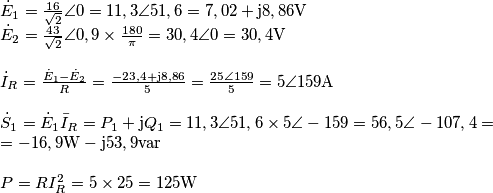

Messaggioda Foto Utenteadmin » 8 feb 2021, 18:24
\begin{array}{l}
{{\dot E}_1} = \frac{{16}}{{\sqrt 2 }}\angle 0 = 11,3\angle 51,6 = 7,02 + {\rm{j}}8,86{\rm{V}}\\
{{\dot E}_2} = \frac{{43}}{{\sqrt 2 }}\angle 0,9 \times \frac{{180}}{\pi } = 30,4\angle 0 = 30,4{\rm{V}}\\
{{\dot I}_R} = \frac{{{{\dot E}_1} - {{\dot E}_2}}}{R} = \frac{{ - 23,4 + {\rm{j}}8,86}}{5} = \frac{{25\angle 159}}{5} = 5\angle 159{\rm{A}}\\
{{\dot S}_1} = {{\dot E}_1}{{\bar I}_R} = {P_1} + {\rm{j}}{Q_1} = 11,3\angle 51,6 \times 5\angle  - 159 = 56,5{\angle ^{}} - 107,4 = \\
 =  - 16,9{\rm{W}} - {\rm{j}}53,9{\mathop{\rm var}} \\
P = RI_R^2 = 5 \times 25 = 125{\rm{W}}
\end{array}

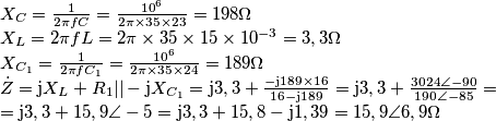

Messaggioda Foto Utenteadmin » 9 feb 2021, 0:35
\begin{array}{l}
{X_C} = \frac{1}{{2\pi fC}} = \frac{{{{10}^6}}}{{2\pi  \times 35 \times 23}} = 198\Omega \\
{X_L} = 2\pi fL = 2\pi  \times 35 \times 15 \times {10^{ - 3}} = 3,3\Omega \\
{X_{{C_1}}} = \frac{1}{{2\pi f{C_1}}} = \frac{{{{10}^6}}}{{2\pi  \times 35 \times 24}} = 189\Omega \\
\dot Z = {\rm{j}}{X_L} + {R_1}|| - {\rm{j}}{X_{{C_1}}} = {\rm{j}}3,3 + \frac{{ - {\rm{j}}189 \times 16}}{{16 - {\rm{j}}189}} = {\rm{j}}3,3 + \frac{{3024\angle  - 90}}{{190\angle  - 85}} = \\
 = {\rm{j}}3,3 + 15,9\angle  - 5 = {\rm{j}}3,3 + 15,8 - {\rm{j}}1,39 = 15,9\angle 6,9\Omega
\end{array}
\begin{array}{l}
{{\dot I}_L} = \frac{{{{\dot E}_2}}}{{\dot Z}} = \frac{{30,4}}{{15,9\angle 6,9}} = 1,91\angle  - 6,9 = 1,9 - {\rm{j}}0,229{\rm{A}}\\
{Q_L} = {X_L}I_L^2 = 3,3 \times {1,91^2} = 12{\mathop{\rm var}}
\end{array}
\begin{array}{l}
{{\dot I}_C} = \frac{{{{\dot E}_2}}}{{ - {\rm{j}}{X_C}}} = \frac{{30,4}}{{ - {\rm{j198}}}} = {\rm{j}}0,154{\rm{A}}\\
{{\dot I}_2} = {{\dot I}_C} + {{\dot I}_L} - {{\dot I}_R} = {\rm{j}}0,154 + 1,9 - {\rm{j}}0,229 + 4,67 - {\rm{j1,79}} = 6,57 - {\rm{j1,86}} = 6,8\angle  - 15,8{\rm{A}}\\
{{\dot S}_2} = {{\dot E}_2}{{\bar I}_2} = {P_2} + {\rm{j}}{Q_2} = 30,4 \times 6,8\angle 15,8 = 199{\rm{W}} + {\rm{j56,3var}}
\end{array}
la corrente nel condensatore anticipa di \pi /2 rad la tensione di e2(t)
{i_C}(t) = 0,154 \times \sqrt 2 \cos \left( {70\pi t + 1,57} \right )
per la corrente i0(t)
\begin{array}{l}
{{\dot I}_0} = {{\dot I}_L}\frac{{ - {\rm{j}}{X_{{C_1}}}}}{{{R_1} - {\rm{j}}{X_{{C_1}}}}} = 1,91\angle  - 6,9\frac{{189\angle  - 90}}{{190\angle  - 85}} = 1,90\angle  - 11,9\\
{i_0}(t) = 1,91 \times \sqrt 2 \cos \left( {70\pi t - \frac{{11,9\pi }}{{180}}} \right)
\end{array}
