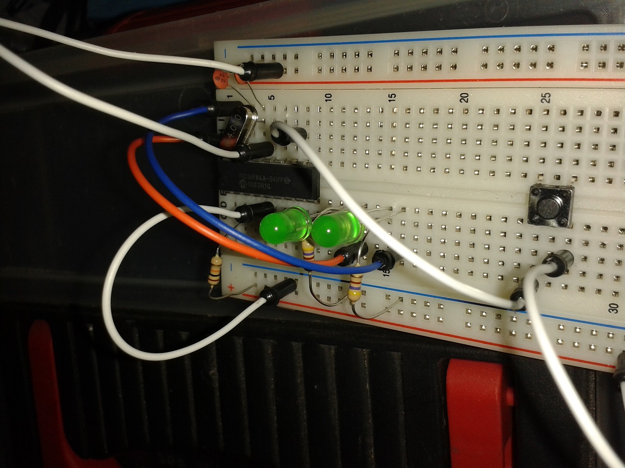

ecco qua, codice e foto:
- Codice: Seleziona tutto
PROCESSOR 16F84
RADIX DEC
INCLUDE "P16F84.INC"
ERRORLEVEL -302
__CONFIG 0x3FF1
LED0 EQU 0
LED1 EQU 1
LED2 EQU 2
LED3 EQU 3
SWITCH EQU 0
CBLOCK 0x0c ;dichiarazione variabili
Count:2
ENDC
ORG 0x00
goto start
ORG 0x04 ;interrupt handler
btfsc INTCON,RBIF
goto tastoPremuto
start
bsf STATUS,RP0
movlw B'00000000' ;imposto gli I/O
movwf TRISA
movlw B'00100001'
movwf TRISB
bcf STATUS,RP0 ;spengo i led
clrf PORTA
movlw B'00000000'
movwf PORTA
movlw B'10011000' ;interrupt enable
movwf INTCON
bsf OPTION_REG,INTEDG
mainloop ;attesa dell'interrupt
call Delay
bsf Count,0
goto mainloop
tastoPremuto
call Delay
bcf STATUS,RP0
movf PORTB
btfss PORTA,LED0 ;controlla se i led sono accesi
goto accendi ;se sono spenti li accende...
btfsc PORTA,0
goto spegni ;...altrimenti li spegne
accendi
bsf PORTA,LED0
bsf PORTA,LED1
bsf PORTA,LED2
bsf PORTA,LED3
movlw B'10011000' ;ripristino interrupt
movwf INTCON
retfie
spegni
movlw B'00000000'
movwf PORTA
movlw B'10001000' ;ripristino interrupt
movwf INTCON
retfie
Delay ; delay software
clrf Count
clrf Count+1
DelayLoop
decfsz Count,1
goto DelayLoop
decfsz Count+1,1
goto DelayLoop
return
END
