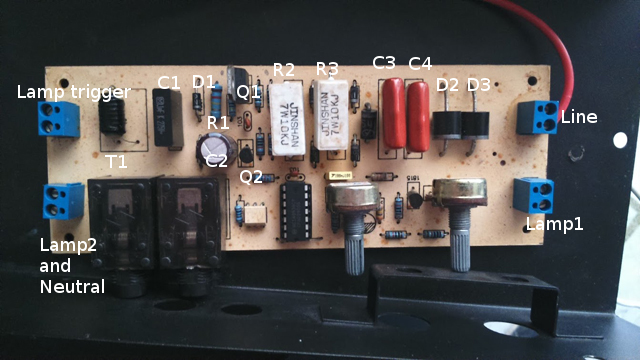

:-) A parte i collegamenti, si è parlato di scintille ma non vedo (almeno io) tracce evidenti di sfiammate...
il componente bianco a sei piedini a sinistra dell'integrato che sigla riporta ?
Con quella foggia lo riterrei un optoisolatore ma due dei piedini stanno in fori a cui non corrisponde alcuna piazzola (ne tantomeno pista) e la cosa mi fa un po' strano... :? O_/
P.s. L'integrato MC14093BC etc. è praticamente un CD4093 ("buffered") ma della Motorola (li siglava così :mrgreen: )

Le due prese jack sono un IN e un OUT

"The tube is directly in series with the mains, via the large diodes D2, D3. This is common; once fired, the tube can conduct for (at most) one half-cycle. On the second half-cycle the diodes block and the tube has time to extinguish. C4 is accross the tube (and seems to be charged through C3 and a diode). When the tube fires, it will absorb all the energy from C4 and then contuniue to conduct for the rest of the half-cycle.
The trigger pulse is produced at the secondary of T1 and applied between Lamp2 and the Trigger terminal. To generate this pulse, Q1 conducts and discharges C1 through the primary of T1 into Neutral. C1 is then re-charged via D1 and R1 from the Line conductor. Q1 looks like it might be a Triac and is driven by Q2 via a capacitive coupling C5. Could this be a relaxation oscilator? I'm not sure if Q2 is driven from the DIP16 or the optocoupler... It's hard to be know how the control is done."
Che ne pensate di questa spiegazione?
