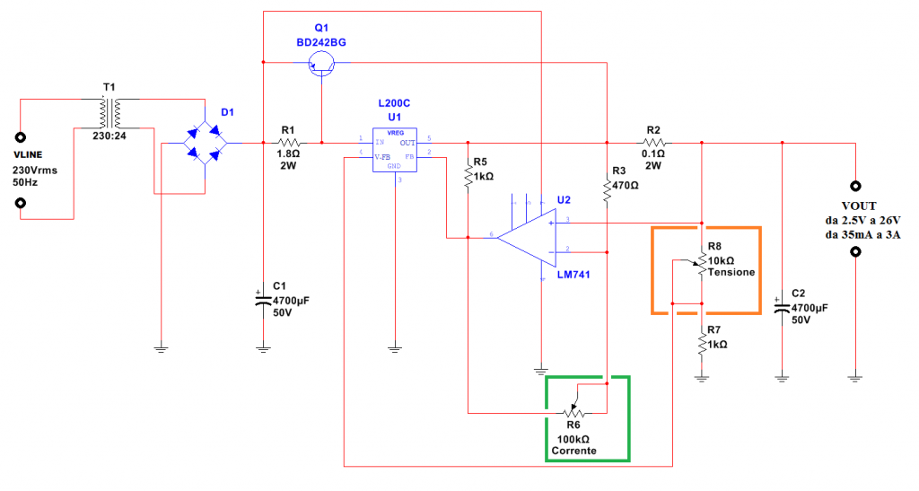

buongiorno amici,chiederei un parere se convenga o meno autocostruirsi un alimentatore regolabile sia in corrente che in tensione,ho visto su amazon che a 60€ ce n'è sta uno da 5A e 30V
ma ho anche trovato un circuito non troppo complesso:
https://www.google.com/amp/s/www.ne555. ... abile/amp/
che però è da 3A e credo al
massimo 24 V , ma io vorrei qualcosa che possa arrivare anche a 60V ( il trasformatore c'el'ho già..
anzi,ne ho ben 3 che potrei mettere in parallelo per una corrente di tutto rispetto..)

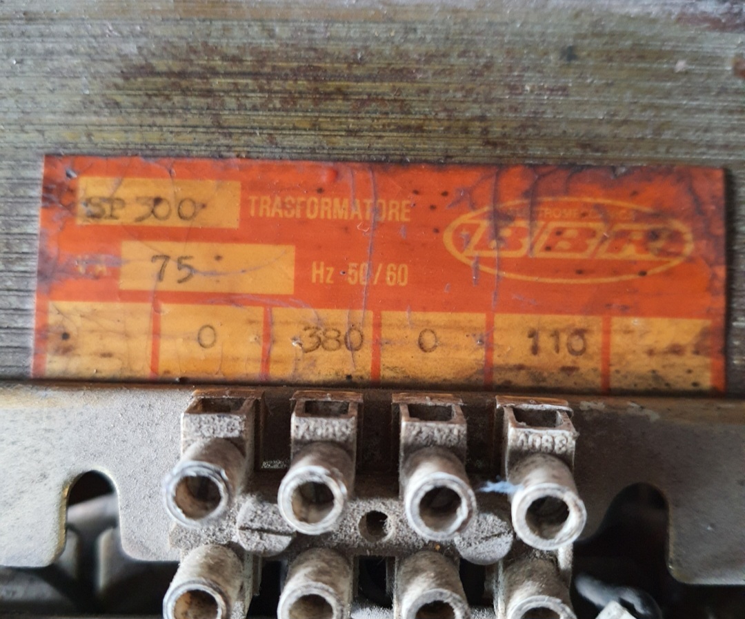

Messaggioda Foto Utentepino81 » 1 mar 2023, 15:39
questi sono i dati di targa di quello più grande ,gli altri 2 che invece sono circa l'80% del primo non si leggono più..
ho visto che alimentati a 220 V emettono circa 70V ciascuno

Messaggioda Foto Utenteelfo » 1 mar 2023, 15:56
Bob Pease
What’s All This Power-Supply Design Stuff, Anyway?
https://www.electronicdesign.com/techno ... uff-anyway
There is nothing simple about making your own 60-volt power supply, especially at 5 A. None of your suggestions are suitable for actually building one, not for a hobbyist, and not for a serious engineer. If you want a reliable supply that will survive serious use, you should just buy one, or plan to put in dozens of hours of work at 40 cents per hour, to design and build one. Note 99.9% of such designs will indeed be ‘quick and dirty;’ they will die quickly, and go up in dirty smoke. A power supply used at a ‘hacker bench’ will very likely get connected to some load that will blow it up. Thus, especially for a ‘hacker bench,’ you'll want a safe and reliable supply. A ‘hacker supply’ on a ‘hacker bench’ will just need fire-extinguishers. Fuses ain't good enough for protection. I put that design at 30 V max and 3 V min, for good reasons. Power supplies can nottttt be extended from 30 V to 60 V with any good reliability at all. They are also not easily extended down to 0 volt. That takes a completely different design! Anything beyond 1 A will take some careful design. ‘Quick-and-dirty’ is a very bad idea.

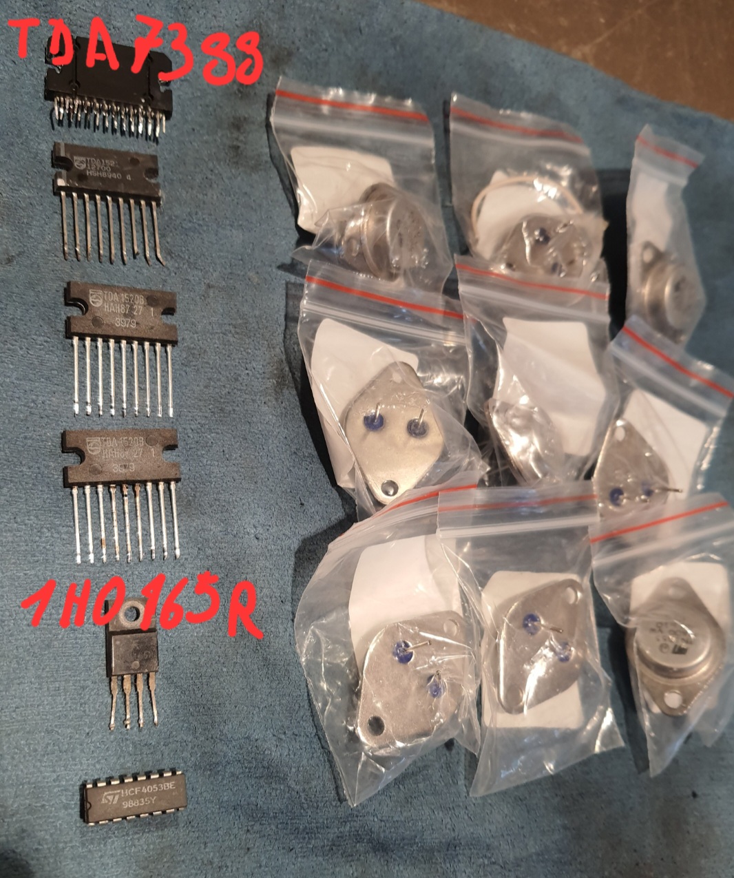

Messaggioda Foto Utentepino81 » 1 mar 2023, 18:08
va bene.. sicuramente non si pretenderanno chicche come protezione dai corti,sovraccarichi,ecc... a 60V 5A sono una bomba da gestire... magari all'aumentare della tensione diminuirà la corrente gestibile...
io provo a mettere dell'altra carne alla brace per vedere se ho magari il tutto per realizzarlo,tipo transistor, amplificatori..
sicuramente potrei ottenere qualcosa di superiore a quelle ciofeche di switching cinesi da 1,5 a 16V che generano rf che richiamano pure gli alieni...

Messaggioda Foto UtenteMarcoD » 1 mar 2023, 19:28
Qualche numero approssimato:
70 Veff a vuoto >> 70 x 1,41 = 99 V di picco a vuoto
che supponiamo scendano a 70 Vdc con carico 5 A
60 V dc x 5 A = 300 watt erogati
70 x 5 = 350 watt trasmessi dal trasformatore.
Se vuoi erogare 12 V a 5 A ne dissipi in calore (70-12)x 5 = 290 watt nel regolatore.
