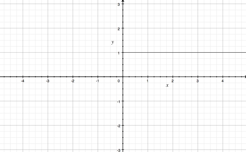

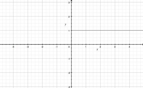

\Phi =\arctan \left( \frac{\mbox{Im}}{\mbox{Re}} \right)+\pi \cdot \Theta \left(- \mbox{Re} \right)
\Theta:
