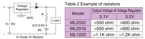

Su ciò che bisogna attenzionare/modificare a livello circuitale già accennato da gammaci in un suo intervento, posso solo aggiungere alcune informazioni sui circuiti "raccomandati" dove alloggiare le 2 differenti tipologie di batterie, reperite su pdf relativi rispettivamente alle maxell ricaricabili e alle CR primarie:
-Maxell ricaricabili
How to select a protective resistor for the current control
The maximum charge current flows in the battery when charged at an end voltage of 2V. Therefore, the value of the resistor is calculated using this equation:
(R) >= ((Output Voltage of Voltage Regulator)-2) / (Nominal Charge Current)
For example, the S-812C series, which has a maximum input voltage of 18V, or the S-817 series with a maximum input voltage of 10V (Seiko Instruments Inc.) can be used as a voltage regulator.
Note 1: If the main power source voltage is stable, the charge voltage can be allotted from main power source divided by the combination of resistors.
Note 2: Because the battery height must be changed by charge and discharge cycle, place a minimum of 1mm space between the battery and device or chassis.

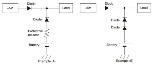

-CR primarie "Circuit Design for Back-up Use"
This is a primary battery and cannot be charged. If used in memory or RTC back-up applications, be sure to use diodes to prevent charging from the main power source or other batteries, and a protective resistor to regulate the current as shown in the figure below. Note that the points described below should be taken into careful consideration when selecting diodes and protective resistors.
Using and setting protective resistors
A protective resistor is used to prevent the battery from being charged by large surges of current during diode failure. Please set the resistor so that the maximum current shown in the right table is not exceeded. For example, say a CR2032 battery is used in sample circuit (A) in combination with a main power source 5 volt. Since the permitted charge current is 10mA and this battery’s voltage is 3V, let the resistor be
R>=(5V-3V)/10mA=0.2k ohm,
meaning that at least 0.2k ohm is required.
