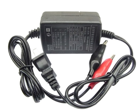

Messaggioda Foto Utenteelfo » 24 dic 2017, 12:11
edgar ha scritto:con passo 0,65 e pad sottostante :mrgreen: :mrgreen: :mrgreen:
LANDFOX Car Truck Motorcycle 12V Smart Compact Battery Charger Tender Maintainer NEW
https://www.aliexpress.com/item/Car-Tru ... eLevelAB=5
US$ 3.64 free shipping to Italy
Input: AC 100-240 V, 50-60HZ
Battery is full (LED turns red, charging stops)
