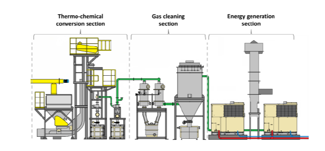

2.2 Innovative biomass gasifier
The biomass gasification system has been developed by Yanmar Research Japan (YRJ) one of the 3 research centres of Yanmar Co. Ltd.
Wood chips delivered from local suppliers feed the small-scale system.
The gasifier has an average feed rate of 47 kg/h and represents the first installation outside Japan.
The fixed-bed reactor is downdraft open-top, based on a specific innovative design coupled to a large number of control sensors that allows high automation and flexibility.
Furthermore, the particular design makes possible to process high ash content biomass like rice husk.
Figure 1: Scheme of biomass gasification system developed by YRJ
In Figure 1, a scheme of the main layout of the gasification system is reported.
In the thermochemical conversion section (on the left) is visible the bottom hopper, the reactor, two cyclones and relative char&ash bins.
In the centre of the scheme of Figure 1 is depicted the gas cleaning section, carbon particles in the hot gas are filtered and then gas coolers and scrubbers remove tars.
Finally, the cleaned and dry producer gas is used as a fuel into cogeneration units. The gasifier has more than 2400 cumulated operating hours since its installation.

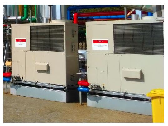

2.3 Combined heat and power units (CHP)
Yanmar CP25VB3Z natural gas cogeneration unit has been adapted to use producer gas as a fuel [3].
The four-cylinder reciprocating engine produces 20kWe.
33kWth are recovered and sent through the heat network to end local users, for either direct use inside the factory during winter time, or indirect use, via an absorption chiller, during summer time inside engine test benches rooms.

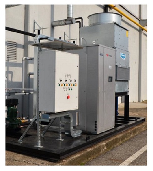

The YAZAKI WFC SC 20 absorption chiller unit is installed on a pre-engineered skid module by MAYA and use as the working fluid an aqueous solution of lithium bromide.
The characteristic COP (coefficient of performance) is 0.7, operating as a single effect absorption cycle, producing chilled water at 7 °C, when fed with hot water from the CHP plant at about 90 °C.
The very unique characteristic of this absorption chiller is the wide acceptable hot water temperature range from only 70 °C to 95 °C.
Figure 2: Yanmar CP25VB3Z, hot water pipes (red and blue) of heat networks are visible

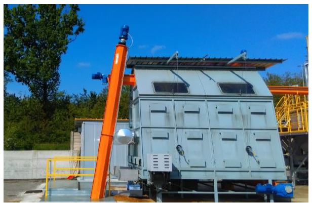

2.5 Wood chips dryer
The novel dryer and storage system has been designed during joint research project between University of Florence and YRE.
The innovative concept, that has been optimized through fluid dynamic studies, aims to control the fuel stratification thanks to a peculiar inner geometry and wood extraction system.
Figure 3: Patented drying system, the vertical screw is for load of wet wood chips
The drying medium is air, heated up to 81°C by water-air counter-flow heat exchanger.
The box capacity is 24 m3 and has an average wood chips residence time of about 96 hours.

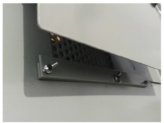

Adjustable outlet air gates (figure 4) and variable frequency drive of fan can modify the drying medium velocity and direction.
Furthermore, a specific control logic, a relative humidity of ambient air, and a variable speed blower can exploit the natural drying potentials during some hours of the day.
Thanks to this features the hot water consumes for dry the biomass is decreased and, as a consequence, the heat and cooling power used for other purposes inside the factory increased.
Figure 4: Detail of opening gate for dryer medium exhausts

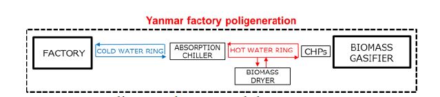

2.6 Local poligenerative Network
Polygeneration consists in simultaneous production of electric energy, thermal energy (heat or cool) and biochar.
The best advantage by installing such a kind of technology can be achieved by exploiting simultaneously different energy forms or byproducts.
Thermal power is transmitted through a hot water ring and its supply is controlled by means of a three way valve that is actuated automatically by a PLC.During winter season the heat is mostly addressed to the biomass dryer.
On the other hand, during middle and summer season, the heat request by the dryer drastically decreases thanks to the natural drying process previously described and simultaneously, the cooling request by the factory finds its seasonal peak.
As a consequence, the heat is supplied to an absorption chiller that is capable of generate the cooling power to be sent to the factory loads.
Thanks to natural drying process the system can valorize heat both during summer and winter season and can optimize the running hours of both CHPs.
Figure 5: Poligenerative network layout
