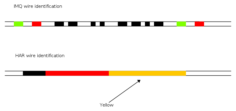

Mark of quality IMQ - HAR
the IMQ(IEMMEQU) or the mark HAR (harmonized type cables) can be printed on the sheath or on the insulation or on textile yarn.
