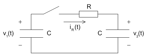

The problem that we will study in this article is that of the energy balance in a simple parallel between two capacitors.
Considering the insertion of two parallel capacitors, charged at different voltages, one can verify that, there is a difference between the total energy stored in the system before switch on and the total final one.
Assuming for simplicity two equal capacitors, and only one capacitor charged, the total energy of the initial and final system will be
witha loss exactly equal to half the initial one .

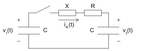

The problem can be solved if we consider a simplified lumped model with the loop resistance R (and / or inductance L), always present in reality, but we want to know if the result is acceptable for R going to zero.
Lumped model
Consider as initial model for the study of the system, a lumped circuit model comprising two capacitors and one resistor R in series. We will show that, if accepted this circuit representation, the missing energy equals that dissipated by Joule effect by the resistance R.
Power on R will be
and then
recalling that i(t)dt will be equal to the decrease of charge -dq in the first capacitor and to the increase of charge +dq in the second one,
equal to the missing energy ΔW.
As the result is independent of R value, the problem seems solved.
A critical analysis of the results, however, makes us realize that, with serie resistance close to zero, the high currents and low time constants, bring into serious doubt the validity of the model , without doubt a part of the radiated power will be lost !
A more complete classical analysis is treated in Rif. [8], [1] e [5].

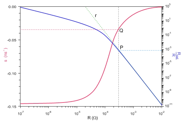

Adding R
If we consider the ohmic resistance, the differential equation becomes more complicated
that would generally be solved only by a numeric way
we will not give here the detailed complete solutions, given in Appendix A,but only the results related to a current loop of radius b=5 cm and an equivalent series capacitance equal to 100 μF.
The following chart shows, depending on the ohmic loop resistance'R , the ratio of radiation resistance to real Joule resistance , and also the decay constant related to Vc(t).
As we can see, for R greater than some tenths of milliohms, the time constant is still approximately equal to RC and the ratio between radiated power and Joule power dissipated in R is less than 1/1000.
[From fig.6, for R=0.3 milliohm, we read -0.033 for s, so
(point Q) and 0.8/1000 for power ratio (point P)].

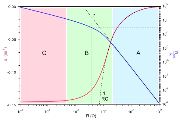

We can divide the graph into three main zones (fig. 7):
- A,in which the influence of radiation resistance is negligible,and where we see how, s(R) functions and power ratio are well approximated by the simple 1/RC, the former, and by the r line the latter, because in A zone A
- B, characterized by a gradual transition between the weight of the two powers, the point of equality in our case will be for R equal to 40 microohm,
- C, where the radiation resistance assumes a predominant role; time constant saturate near 7 ns (1 / 0.146) allows us to validate the initial assumptions on the time allowed for propagation in our hybrid model.

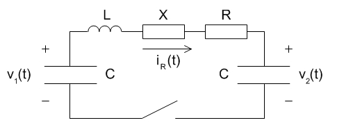

Adding L
To complete the analysis at this point it is necessary to take into consideration the coefficient of autoinduction L, certainly not zero for a real loop ,
lead to a more complex differential equation
The Vc analysis can be obtained only through numeric solution and is restricted in [2], to particular values of circuit parameters R, L and C.
To restrict the number of possible choices will be useful to evaluate the order of magnitude of the resistance and inductance associated with the geometric model.
Assuming a copper conductor with radius a equal to 0.5 mm,
This parameter should be considered only indicative, as the inverse square dependence by a let for R large range of values.
For the inductance associated with the circular geometry use
in this case, the inverse logarithmic dependence of 'a' will lead to less sensitivity to the diameter of the wire and reduce the possibility of variation of L mainly to a reduction in the development of conductive connection between the two capacitors.
With these values, the circuit will always under damped and the radiation resistance, at the resonant frequency , will be generally negligible compared to the ohmic one, also reducing the capacity to 1 nanofarad .
In [2], while underlining the limit condition, it is supposed to reduce to ten microohm R and L to a nanohenry to still be able to achieve equality between ohmic resistance and radiation
In my humble opinion impracticable conditions, since such a reduction of resistance would have to take into account the series resistance of the capacitor (previously neglected), and the reduction in the self induction to few nanohenry would also be impractical, as I have wrote, without any connections reduction.

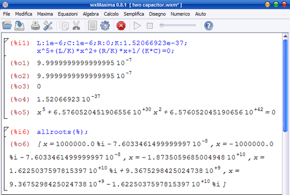

For a numeric solution of the
The equation will be characterized, as appropriate, by setting the values of circuit parameters.
For the numerical calculation of the roots, we can use wxMaxima, enter the values for L, C, R, K, and define the function f(x), with "allroots" you can obtain the zeros of the function
in the example we have used a LC loop with R=0.

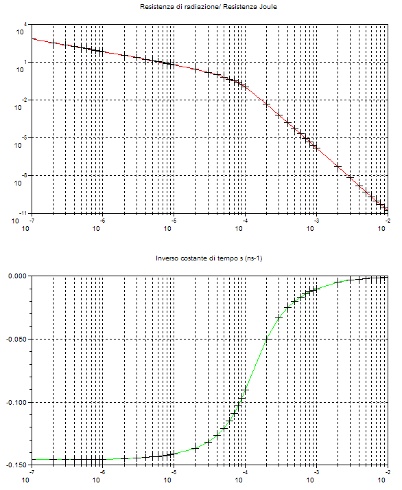

Wanting to derive a complete graphical representation of changes in both the relationship between radiation resistance Rrad and ohmic resistance R, is the function s(R), it is more convenient to use Scilab.
Just a script to calculate and draw the curves

You get the following two graphs
equal to those of Figure 5 in Boykin's article [2].
You notice the 50 values calculated for the real root of the associated equation, the conjugated imaginary pairs solutions are not acceptable, as shown in [2].
