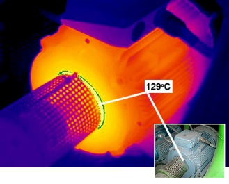

Thermography
Thermography requires heating the component to be tested and measuring the temperature T which comes as a result of infrared radiation emitted from the surface and detected by certain sensors.
This type of test is based on the principle of emissivity that is the ability of material surface to emit energy by radiation.
The image is captured through a camera, "connected" to a software that allows to scan the picture, drawing a map with different levels of thermal colors, which distinguish the various levels of radiation.From observations of the indications are identified, then the defects.
Thermography is mostly used in construction, energy sector and automotive.
