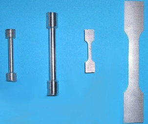

Description of the specimens used
The specimen is normally produced through a mechanical working of a piece drawn from a product. However all the products with a uniform cross-section (such as extruded profiles, bars and tubes) and rough foundry's specimens can be used without a preliminary mechanical working.
Specimen's section can be circular or rectangular. However, independently from the dimensions and the type of section, it is possible to define, in the specimen, a length with a uniform cross-section , Lc , and two shoulders (or heads), which dimensions depend from the testing machine's tightening grips, filleted to the length we named Lc . The fillet is necessary in order to avoid local over-stress and to have a uniform load distribution on specimen section.
In the length named Lc it is also possible to recognize another characteristic length named gauge length, L0.
Before the test the gauge length is divided into five or more equal lengths by using a machine called tracing machine or specimens marking machine, in order to measure specimen's elongation after the test.
The following images show an example of tracing machine:
There aren't requirements about specimen's form and dimensions, but it is necessary a good surface finish in the length with a uniform cross-section, Lc.
In the following images there are represented round cross specimens and flat ones:

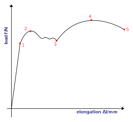

After the test, it is possible to deduce, by using a plotter, the strain-stress curve, that is a diagram in which the loads F are a function of the elongations Δl.
The following one belongs to a mild steel, which is an example of ductile material:
From the stress-strain curve it is possible to extract some characteristic values, that are:
- proportional limit stress Fl : up to this value, indicated by point 1, is respected Hooke's law: in this lenght the material has a linear elastic behavior, defined by a linear stress-strain relationship in which deformations completely disappear after the removal of the load;
- yield strength, whose maximum, FeH, is at point 2 and the minimum, FeL, is at point 3; beyond this value deformations are plastic and so specimen will not return to its original dimensions and form after the load is removed;
- maximum strength (given by point 4) : this value represents the maximum load which can be tolerated by specimen;
- ultimate strength (given by point 5) : beyond this value the specimen goes to failure.
