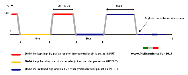

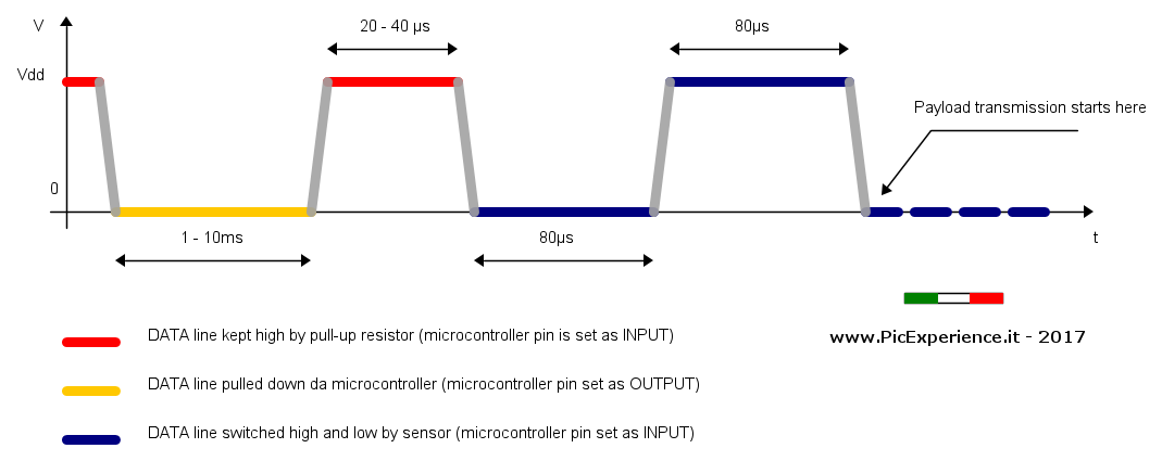

Each time micro talks to sensor, it has to start communication with these operation: since DATA line is kept high by a pull-up resistor, the start-of-transmission signal is given from micro pulling low DATA line for at least 1ms. After that micro sets it DATA pin to input mode and the line goes high (pull-up works) and maintened high at least 20-40 us; then a up-and-down dance of DATA line, driven by sensor, as described in the following picture.
Picture 8 - Startup sequence

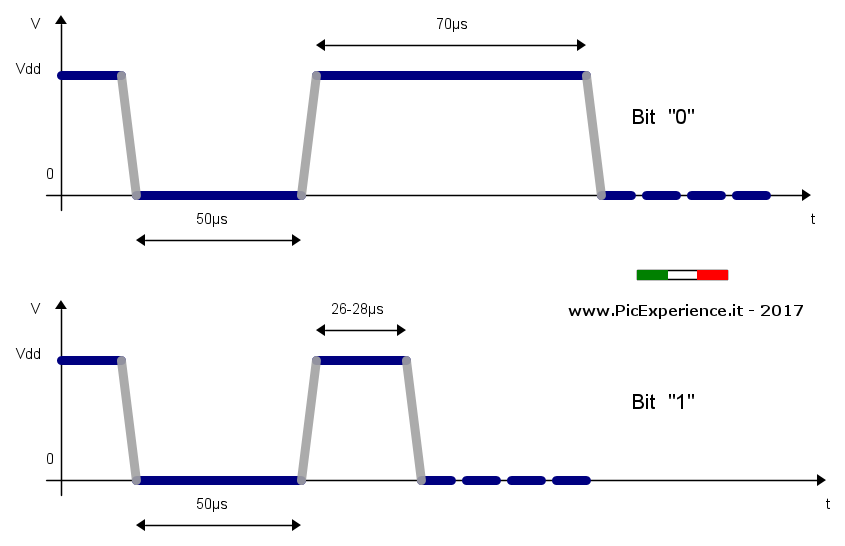

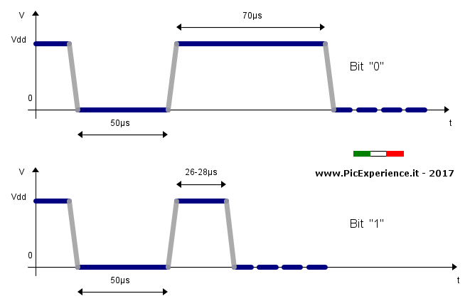

Once startup-sequence has finished, sensor trasmints data to micro. As said, sensor sends 5 bytes, total of 40 bits. Each byte is coded as follow:
- a single bit is 0 if the low-high sequence has timing of 50us and 70us
- a single bit is 1 if the low-high sequence has timing of 50us e 26-28us
Picture 9 - Bit 0 and bit 1

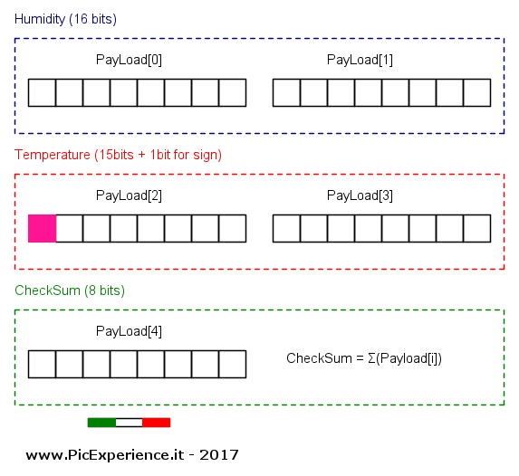

Relative humidity, temperature and checksum
First two bytes received are about relative humidity, expressed as parts of thousands, not percent. So, if HR is 37.5%, PICmicro receives from sensor a value of 375. Temperature follows, and it is ecpressed as tenth of Celsius degrees, sign included. DHT22 measures temperature form -40°C to +80°C, so it is important to evaluate the sign and then convert the temperature value in Celsius. The last byte is the checksum byte, calculated as 8-bit sum of the previuos four bytes.
Picture 10 - Data payload
