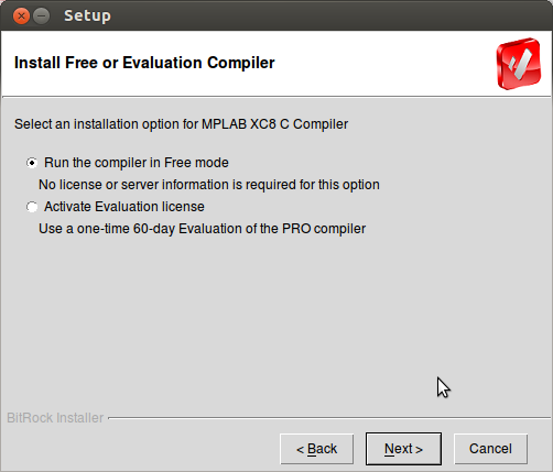

How to install the XC8 compiler
The file xc8-v1_12-linux.tar is an archive whence you have to extract the ".run" executable file.
You can do it from the desktop or from the shell, using the command:
tar -xf xc8-v1_12-linux.tar
It's possible to check whether the file xc8-v1.12-linux.run is executable
It is possible to launch it using the command:
sudo ./xc8-v1.12-linux.run
Now the usual nagscreen will come up with the license agreement to agree with and the choice of the installation type you like.
I installed the free version.
Note: The "sudo" prefix is used to execute commands with the administrator privilege; but not all Linux distributions use this system. In this case it will be necessary to log in as root, using the command su.
I tested this installation procedure with Ubuntu and Suse and, with both operating system, it was successfully completed.
