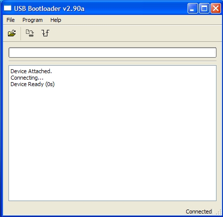

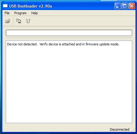

If you are able to launch HIDBootloader (Windows).exe this window will come up
Now we have to connect the USB to the PIERIN board. The LEDs will start to flash. Now press the RESET button, the PC will make the sound of the USB and the bootloader window will turn like in this figure.
We're ready!
