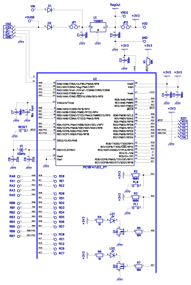

Wiring diagram
Down here is shown the PIERIN PIC18 wiring diagram.
On the top left there is the connector named USB CN2. From the pin 1 of CN2, we get the 5V supplied by the USB, displayed through the terminal +5USB. Across D2 and JP1, 5V reaches the voltage regulator U1. This regulator can be powered by an external source through the terminal VIN, too. The stabilized voltage at 3.3V is available on the terminal VREG (on the top left) and, through JP2, supplies whole the microcontroller circuit. If JP2 is unplugged, the circuit can be powered through the VDD terminal. The capacitors C3, C4 and C5 are bypass capacitors for the rail voltage and C6 and C7 (on the left) are used by internal regulator to generate the USB interface voltage.
Also on the left is the RESET button, the quartz X1 (12MHz) and two capacitors, C8 and C9, for the oscillator. On the right is the connector for the Pickit3. Going ahead downwards we reach the two pushbuttons PL0 and PL1 with their pull-up resistor and connected to pins RD4 and RD5 of the microcontroller, respectively. On the right bottom there are two leds. They are not driven directly by the microcontroller outputs but through the two mosfet Q1 and Q2. This way of doing things allows to save whole microcontroller outputs fan out.

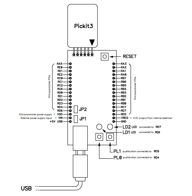

How to connect it
Down here is shown the connection diagram.
Starting from the top we reach the 6 pin connector to connect the emulator/debugger Pickit3. It is used to program the microcontroller and to debug it. Yet, via the bootloader, it is possible to do without the programmer because the microcontroller can be programmed through the USB (on the bottom).
The jumpers JP1 and JP2 are very important because they are used to configure the power line. Let me show how to configure them taking a look to the wiring diagram.
JP1=ON JP2=ON
Stand alone mode.
The power supply will come by the USB connector. 5V (directly from the USB, on the terminal +5USB) and 3.3V (stabilized, on the terminals VDD and VREG) are available.
JP1=OFF JP2=ON
The board will need an external power supply, connected using the VIN terminal, because it doesn't take the power from the USB. The internal stabilizer is still working and supplies correctly the microcontroller and, eventually, could supply an external circuit. The 3.3V is available through VDD and VREG terminals.
JP1=ON JP2=OFF
The voltage stabilizer is powered by the USB, but it does not supply the microcontroller that needs an external power supply by the VDD terminal. The stabilized 3.3V voltage is available by the terminal VREG.
JP1=OFF JP2=OFF
The stabilizer is not supplied by the USB. It doesn't supply the microcontroller that needs an external power supply by the terminal VDD.
